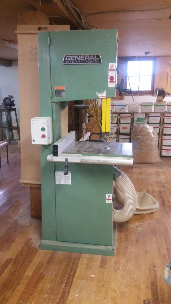

General International 17” bandsaw. Blade Length: 131.7" (3345mm)
Model : 90-240 M1
S/N :
91961305
HP : 2
Volt : 220
RPM : 1720
