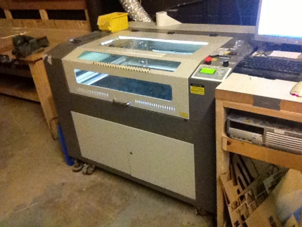

G.Weike model LG900 60w laser engraver

					I tried to use the laser cutter today and it is not cutting, alas.
Using a cut power of 100, and various speeds of 4 8 12 16 and 20 to test, my results were a cut of no more than .1mm deep each time.  The width of the kerf became larger with each slower speed, but the cut\'s depth did not increase.

					I was just informed by Shawn Johnson that he inadvertently (by mistake) pressed the Z-Datum button on the laser cutter, and some adjustment is required before use. (ok fine, Shawn wrote this after Brennan logged into his account, and he\'s watching me now , so this isn\'t a covert hacking operation)

					Bed is levelled.  Occasional problems reported with x-axis jumping inches.  Watch your work careful and report any issues.
